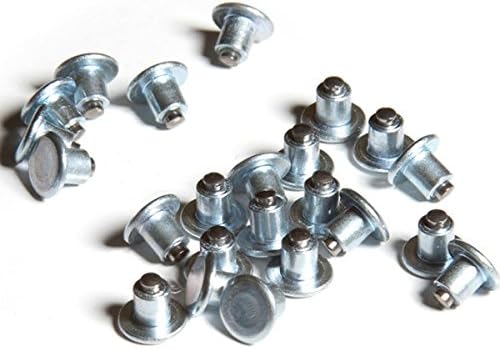

I am in the process of studding a set of specialized ground controls that are on my fatboy, with grip studs.
I paid $300 for 200 studs and the install tool.
I did the front yesterday, and a good number of studs screwed through the tire carcass into the tube, and it went flat, so now I am converting to tubeless, see how that goes…
I have read that gong tubeless with the kold kutters is doable, so if these grip studs don’t work great, I will be switching to those, they are MUCH cheaper than grip studs.

I have a set of Bud & Lou’s with about 150ish Grip Studs and I find them compareable to the Snowshoes on ice (and those have almost 3 times the number of studs). The Bud and Lou’s have way more grip everywhere else. Also with the crazy deepth of them you don’t have to worry about them coming though to the tube.

I’ve got both ground controls studded, and setup tubeless. Front is holding air, rear, not quite yet, but should be ok after a ride.
I’m not sure it’s worth it, with grip studs, I think the knobs are too small and soft, I’m predicting a massive loss of studs off the rear if I ride on any non-snow trail.
I haven’t ridden them yet, waiting for snow so it doesn’t feel like a total waste of time.
It was not particularly easy or enjoyable, but it’s done and I hope they stay studded for at least a few rides!

I have a set of Bud & Lou’s with Grip Studs and after seeing them in person I don’t think there are many other tires that would hold grip studs supper well. The knobs on most tires are just not deep and/or big enough to support them well.
